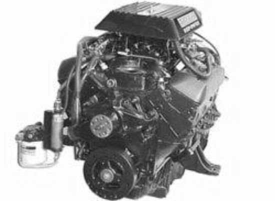

807736R11 =
222 HP Factory Remanufactured 4.3L
Specs: 225 HP @ 4800 RPM ‑ Standard / Left‑Hand Rotation ‑ Remaunfactured 4.3L Partially Dressed Marine Engine Assembly. Features Include: New 600 cfm 4bbl Carburetor, Electric Fuel Pump, Nodular Iron Crankshaft, Roller Camshaft, Vortec Cast Iron Cylinder Heads, Stainless Steel Valves, 9.4:1 Hypereutectic Pistons, Full Roller Rocker Arms and Thunderbolt V Ignition. Includes: Flame Arrestor, Harmonic Balancer, Oil Pan, 10‑Pin Harness, Water Pump, Spark Plugs and Wires. Runs on 86 Octane Fuel.

Ok so that looks like it was a partial engine/extended long block vs a complete bobtail that has the 1G***** serial

Which helps if one can/would keep the original serial number too so you know the correct external parts too theoretically speaking.
