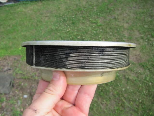

I posted a thread a couple days back about some WOT bogging, getting up to speed issues I am having. I have a 5.0 Liter OMC Cobra drive, 230 HP. I took the spark arrestor off last night and the outside of the "filter" is quite black. Here are a couple of pics. You can see where I wiped it off with my hand, and where I didn't.

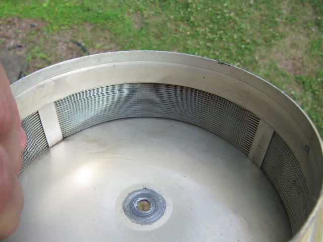

Here is one of the inside, untouched by me.
Couple of questions.
1) What causes the black buildup, is it burning fuel?
2) Is it normal to be this dirty? I have no idea when the PO last cleaned it.
3) How do I clean it? Soak in gas, blow off, air dry?
4) Could something this simple be causing my bogging, lack of getting up to speed?
Yes, it's normal. Oil and fumes from the valve cover is where the black comes from.
DO NOT use gas for parts cleaning. Diesel fuel is better, use a brush to clean the flame arrestor and blow it out with compressed air from the inside out.
It doesn't look near plugged up enough to be the problem.

I had a boat where the engine cover sound deadening foam was rotting, fine dust would come off the foam and adhere to the oil film and clog the flame arrester. The fuzz I see in yours looks familiar.

also i had old belts on my engine that were putting off a lot of dust pulleys were kind of rusty so when i cleaned mine it looked a little worse then yours but wipes right off.
