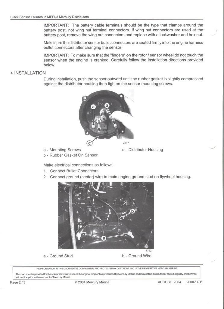

Did you ground the ignition sensor black wire to the battery ground stud at the rear of the engine?

thanks for the replies! I do have the wing nut type connectors on the battery posts, so I will update and tighten using stainless nuts & lock washers as well as charge the battery to make sure it is at peak (battery is 3 weeks old by the way - Marine deep cycle 950 CCA). I did connect up the black wire from the sensor to the stud on the back of the engine ground point as shown in the pic as well as connect the black smaller wire in my harness to the stud on the bottom of the distributor. I did not have "bullet style" connectors as the old wires connected up directly to the old distributor with spade connectors on posts. I cut those off and striped wire ends and then used wire nuts to secure all connections together. ( white w/green trace & white w/red trace wiring). The pre-owned distributor is an OEM unit with a matching part/model number on it to my old one. I am under the understanding GM used this distributor on a lot of models over a lot of years.

Again, thanks for the replies! In answer to the spark plug wire issue.....the wires have been checked THREE times.....2 visually for correct location and connection.....third time with an multimeter for continuity & orientation.....all is in order with the wires. Here are some pics: Also, prior to my doing the tune up work, the boat idled well in the water and did have acceleration and could get up on plane with 6 of the 8 cylinders firing although it took a couple min's and occasionally would run on all 8 cylinders as you could here and feel the horsepower kick in. Hope this helps.

Yeah I understand about the not being here issue to hear and see this engine run.....believe me, I would gladly welcome another experienced person here to add their two cents worth. I did not check engine position when I removed the old distributor....so upon installing the new distributor, I made a tool out of a plug fowler with 14mm threads like a spark plug, attached a 16" length hose to it and to the other end of the hose attached a balloon....put this tool in the #1 cylinder in place of the spark plug.......turned the engine over clockwise by hand.....found #1 compression stroke when the balloon just started to inflate......lined up the timing mark on harmonic balancer to 0 degrees.......put the new distributor in so that rotor is pointing to approx. #1 large numeral on cap.....finger tightened rotor hold down tab in position, secured cap & wires & grounds.....(distributor is flush with block).....rotated cap to approx. position of old cap which was maybe 10-12 degrees....very close to initial idle advance I'd say......and turned the key.....idles right away.....go to accelerate and she loads down right away.....moved cap 10-15 degrees either way a little at a time while engine running to see if anything changes with acceleration....nope.....but idle does cough out at either end point of clockwise or counterclockwise movement of distributor........
also....no plugs on ignition amplifier/brain box.....wires go directly inside unit. It is secured to water manifolds with 4 bolts...how much better grounding does it need?
I can take a few more pics.......& I'd be glad to send a video.
