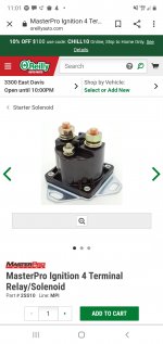

This is the one I replaced my old one with (both pictured) I bet that is exactly my problem. So in theory I think then if that is the case I can still use that solenoid just only use three terminals? (Thats what the packaging said would be a possibility) or am I wrong?

Get the right parts !-----Not automotive.----Hopefully you have not damaged any other parts with your experimenting.
jerryjerry05
May 7, 2008
18,190
You can probably use the new solenoid but you
have it wired wrong. The new one, the base might
need grounding?
Get a factory service manual, find the wiring
diagram and rewire.

Thanks to everyone for the input, jerryjerry05 was correct i did infact have it wired wrong. Got it taken care of and she's back to running like a dream.
