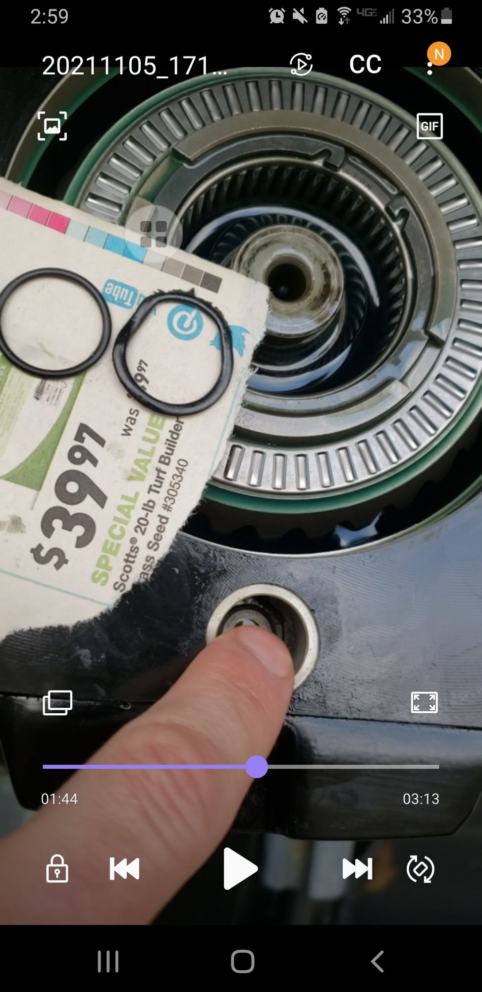

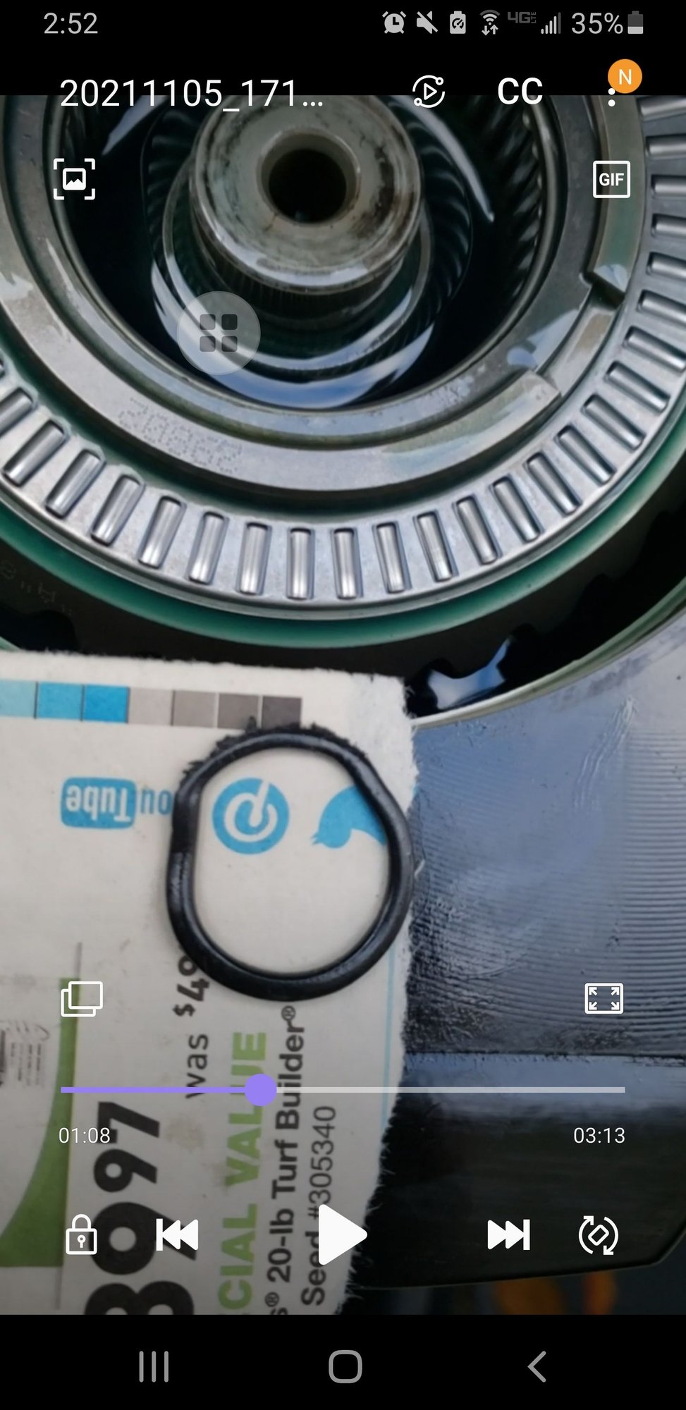

Wanted to follow up with what i found. I removed the top cap and the large oring that fits in the groove on the cap looked fine but the other smaller one that's about .625 diameter looked "slightly" out of round (sarcasm intended on the slightly part!) This one seals the shift shift area below it, I believe. After replacing it and carefully installing the top cap without turning it, I tightened to 19 ft lbs, an no oil leaks whether up or down. Prior to that, I poured a small amount(teaspoon) of drive oil where oring goes (where I'm pointing in pic) and it drained down fairly quickly but not sure if it went into the same area as the gear lube or into the shift linkage area (that is not oil filled)? If it connects to the drive lube area housing the gears, clutch, etc right in front of it, then I feel safe, as the lube with water intrusion has all been drained and replaced with new. If it drops into the shift cam, ball detent, shift yoke area (pg 3A-7 in #28 merc manual) I'd be concerned that water could also have leaked into this area and could freeze and crack something? Can anyone verify where this area leads to? I stored the boat away from home in an unheated indoor storage location a few days ago but could revisit to open the rear cover plate if necessary to see if water entered shift assembly? Just not sure if necessary? Thanks again for any suggestions!
Old vs new oring
\"Slightly" out of round....HAR HAR HAR...note sarcasm in slightly!

I had to fiddlemonky with one of those once. IF I remember correctly, that hole you are pointing to does get oil in it. That's IF I remember correctly.....
