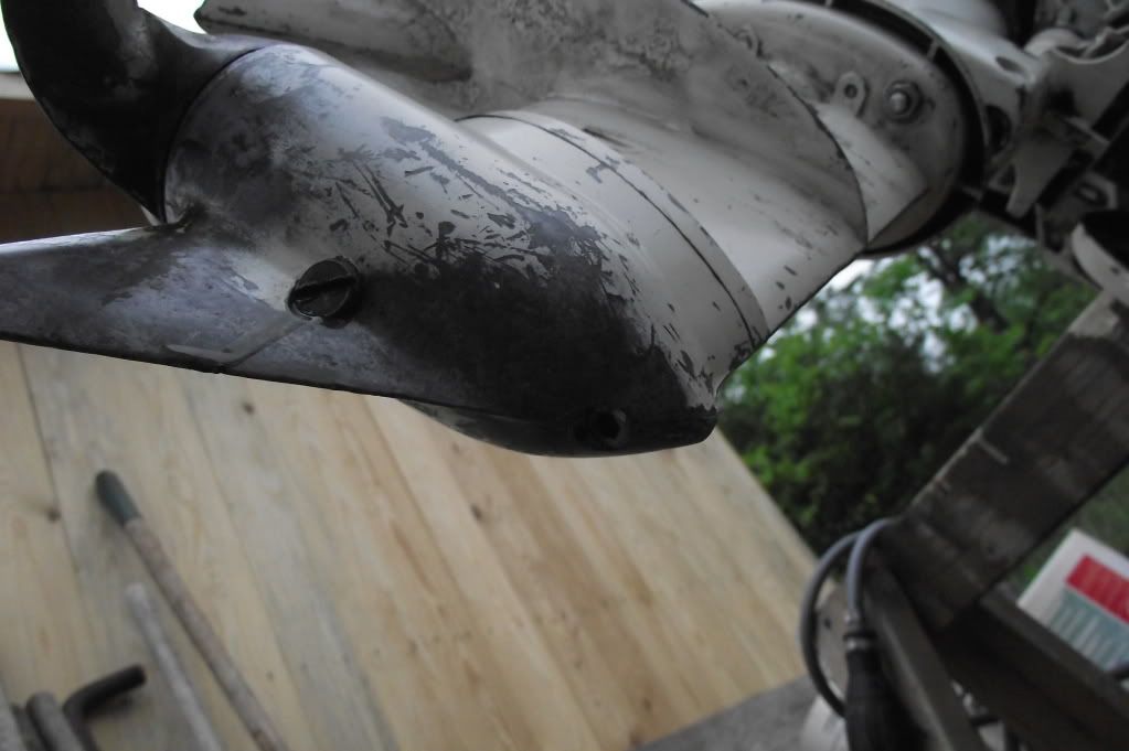

In need of some expertise in identifying single allen head bolt found at the leading edge of the bottom end on a 1965 6501 Westbend Chrysler 6hp outboard (not in manual).
And, how does one replace the prop seal on same since the manual also shows an entirely different process.?
Thanks in advance. Any help is greatly appreciated
Nickc

solely for historical purposes and thread completion, the allen head in question was for removal of the gear case. the other bolt was assessable only after removing the bearing cage, which coincidentally was hidden behind a line cutting plate that initial appeared integral to the bearing cage.
Thanks again for the help, and thanks to iboats.com for affording us this forum
