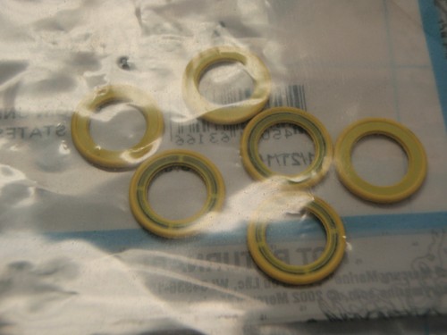

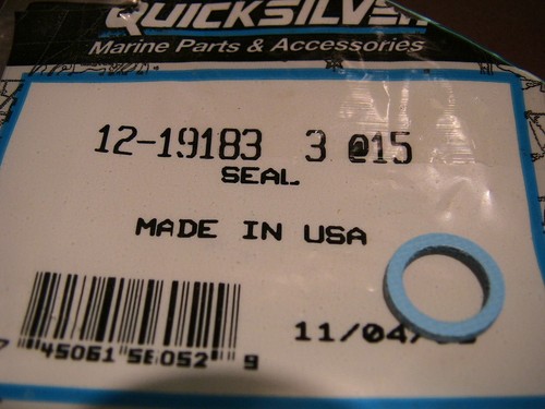

Either you can use the blue gasket part number 12-191833 or the new better yellow gasket 26-830749.
