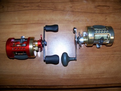

It's on the gold reel.

Well I thought I would update and show pics. I bought two quantum smoke handles and all the parts to them. I am really pleased with the handles and the service I recieved from Quantum/Zebco Brand. So heres some eye candy and if anyone is interested in two abu garcia revo prm handles with knobs and all hardware Pm me or let me know.
Before
After

Looks like it worked out well. How much longer are the Quantum handles?

The stock handles measure 4in knob to knob the Smoke handles measure 4.5in. Doesnt seem like much but made a world of difference.
