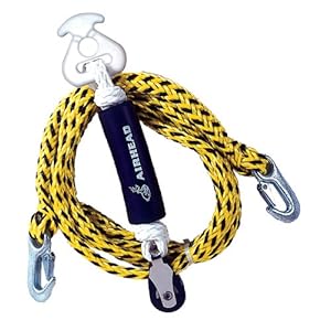

This weekend my kids wanted to try tubing. They are young so mommy had to ride with them..... I was worried about using ski mount so I bought one of these to hook to my tie down loops:
I felt like my boat was tied to the dock....... granted the rope to the tube was 100% under water but i cant imagine it added that much resistance......

A tube pulls easier with a given load, but can put alot of stress on things if it catches on the water, like they do sometimes. The main thing is, alot of big multi person tubes out there plus a very heavy rope like most use for tubing, can be very hard on tow fittings. We tube the kids(up to 100lbs) from the pylon, it keeps the rope up out of the water, but we pull adults from the stern eyes with a Y harness. I used one like you have pictured, but didn't like it since the "pulley action" cut down on how good I can swing the tube side to side. The one you have pictured should suit your needs well though, since I doubt your tubing is going to turn into a "see if you can hold on" type ride.
