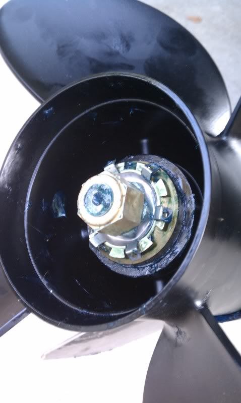

Gah, apparently my boating skills have killed my computer skills, just typed a huge reply and erased it. Short brief, it is a Alpha 1 4.3L, which I put in a Solas Amita #1513-140-21 Aluminum Boat Propeller. When I ordered the prop, Iboat told me to order a spacer, thrust washer, washer(2), and a prop nut. It looked like the piece I didn't use was a spare thrust washer which came with the prop as it wasn't in a OEM box like the other pieces. It didn't seem to fit my spines after the prop. However, the other I ordered fit snug into the spines, and snug to the prop. I did have the bending tabs, and those are engaged.

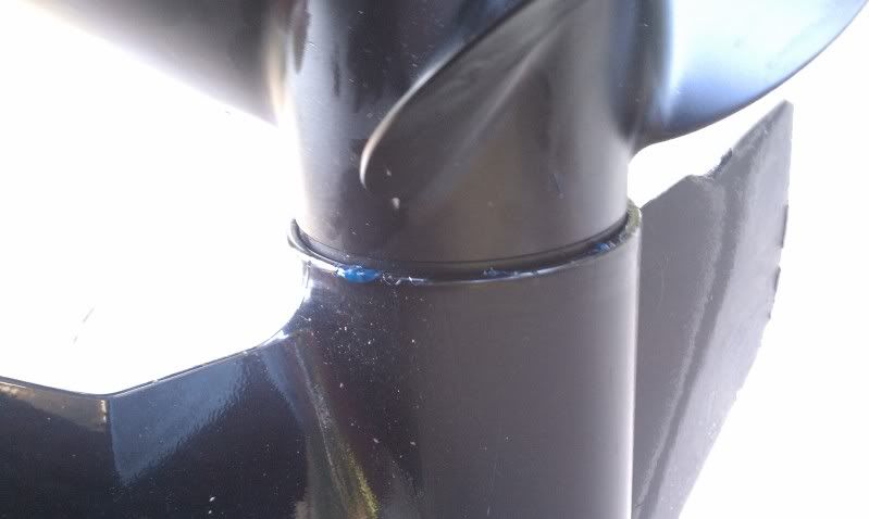

However, now I noticed, if I pull on the prop a little like I am trying to take it off, it does have a little "play" in it. Like it will come back just a hair. I wouldn't think this is right. Is my prop nut not tight enough? Its not even enough to show the prop shaft or anything, just like 1-2 cm if that much.... The second picture shows the blue marine grease, I put some extra to mark the spot where it seems to have play. When I pull just a bit, I can see this spot move. Not enough to show anything other then the black of the prop, but still moves some.http://i115.photobucket.com/albums/n318/wizarddeath/IMG_20110625_192741.jpg

I believe it is normal to have a very small amount of end play. You will have to check your service manual to confirm how much is too much, and check with a dail gauge.

Ok makes sense. Was doing some more googling, and found that it does normally have rear and aft movement. Just can't seem to find out how much.

Glad you posted pics. You did something wrong that needs to be corrected.
This photo you posted:
Shows that you do NOT have the propeller nut seated properly inside the locking washer.
That is why your nut is not seated far enough on the end of the prop shaft.
So loosen it, engage it inside the cavity/depression of the locking tab washer, then tighten it again. I believe 55ft pounds is proper torque for the nut on those Gen II Alphas. That locking tab washer should be held up against the back of the nut so that it will turn WITH the nut as you tighten it...don't just turn the nut down to the stationary locking tab or you end up with the incorrect result you show in your pic. Then activate the locking tabs after the pair are fully tightened. I will also add that it would be a good idea to simply replace that lock washer. By the book, Mercruiser says they are for one time usage....admittedly many of us use it more than once. But you may have crushed/misshapen it the way you have it torqued down right now.
If you bought a kit like this, they are usually generous enough to throw in a second lock washer, so you likely already have a spare lock washer...might be smart to bring into service now since you may have crushed the first one?
http://www.iboats.com/Propeller-Nut...5378744--**********.793513935--view_id.187465
Anywho...the way you have it torqued now there is potential for that nut to come off. The tabs are not stopping the nut from turning because the nut isn't in the cavity.
And no, you didn't need all that grease. Just grease the splines of the shaft and call it good next time. No need to grease all these washers and such. Harmelss, but messy. Yet I still say you should make sure your nut threads do not have ANY grease. So go ahead and back that nut and locking washer all the way, degrease the nut and shaft threads clean & dry...then reattach those two pieces properly. Nothing else needs to be removed.
Otherwise it appears the prop is seated properly to the gearcase and it fits fine.
A bit of pull/push end play is rather normal for Alpha prop shafts. It'll gently clunk back and forth as you pull the prop in & out. I believe 1 to 2 mm is normal. However you said you have 1 to 2 cm?!?! If that's true, that's way too much....internal drive problem. I sincerely hope you guestimated the movement distance wrong. If it is indeed moving in and out 1 to 2 cm, the Mercruiser forum will be more educated and specific about this topic than I am...
