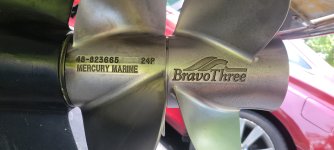

I know this is probably of no help at all, but I did take a pic of the ID on the prop right before I tried to get the motor snap.

The prop isn't going to help us
