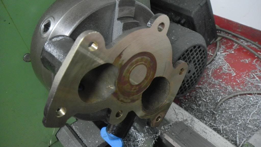

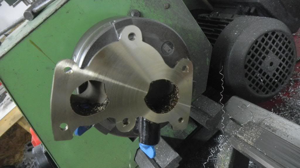

I've been help a buddy with almost the same problem, and even thou we changed the impeller it would still show overheat in the manifolds. So after some googleing it would seem that the sea pump is not the best of designs.
We had small .50mm deep grooves on the two impeller sealing faces, I machined the back face for him and we purchased a new front housing.Ran the boat last night for a hour checking the manifolds and riser with a IR gun from time to time in different conditions of running and all was good.
The pump still didn't prime to quick so need to look at that, but once primed it worked as it should..................... a long with the boat.

I would suggest getting the rebuild kit that comes with the stainless steel wear plate. The impeller will have a harder time wearing into stainless. Many have gone that route to stop the wear on the Gen 7 pumps.
As far as the priming, check the package of the impeller you have. This is a long shot, but there were some impellers made that were a few mm shorter then spec. Most all have been found. I'm working from memory but I seem to remember something about a green dot on the package.
Yeah I think this would be the way to go fitting a repair kit with wear plates...........makes 100% sense with a warn plump. I did check the impeller length as I did read about the length problem, but we do have the correct one 50.80mm/2" but thanks for the suggestion!
Having side exit exhaust makes it easy to see the flow of water at idle, once primed there is really good flow now as before it was just a trickle.
