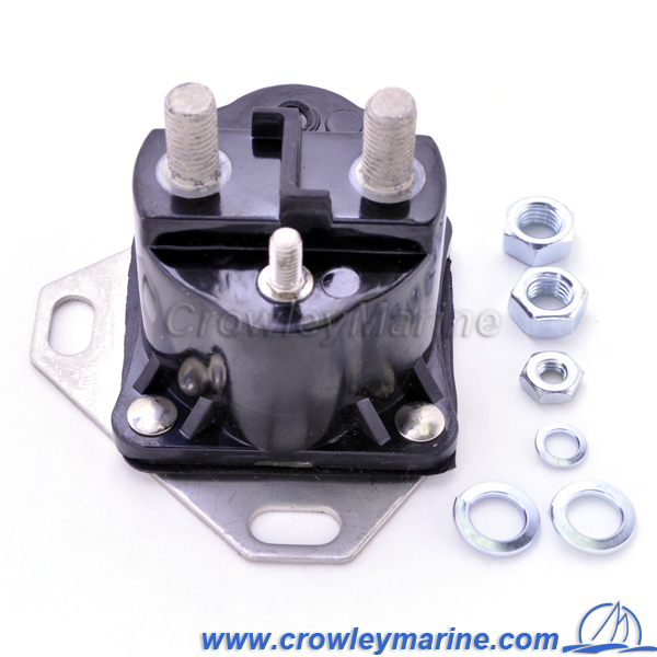

Looks like this:

That's NOT a slave solenoid that's the oil pressure sender.
The slave solenoid is in a cluster with the trim/tilt solenoids.
Might be on the shift bracket.
Find the trim pump and follow the lead back to the solenoids.
