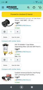

So this is what I decided to get. Gonna try polishing the fuel and burning it in my truck. Next will be figuring out how the hell do much water got into the tank

I was going to get a primer bulb inline like you see on outboards, hopefully I don't need to pump it the entire time? Just a couple pumps to start the flow?
You may get lucky, but I doubt you’ll get enough head pressure to siphon through a filter.
All you need is a small, 12 volt universal fuel pump. Amazon has a number of them under $15
