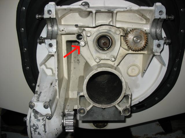

Hi guys, just new to this forum, like what I see, anyway to the point hears my questions, Im repairing my father in laws boat,(he didn't winterize it and filled the block with water) its a 800 series leg 225 OMC, I am removing and replaceing the motor and trying to get the leg off, yeah, you know my first problem, the shift cable):, I read some of the replys on this forum from past threads and tried them all, everything is un-bolted and ready to go but the cable just wont come out, I tried spaying wd40 down both sides of it, I tried putting a pry bar between the upper housing for leverage and pulling as had as I could and now the rubber is chaffing and in danger of tearing, now the other problem I had is the trim motor is seized so I couldn't get the leg down however I was considering removing the lower toothed triangular gear to allow me to drop the leg would this give me any better access to the cable? and worse come to worse if I have to cut the cable how hard is it to change in the leg end?, lastly when I get the leg off finnally what is the next step in order to remove the engine which is already un-bolted and ready to go, thanks in advance, Ed, oh yeah I also tried the two person pulling and pushing on the cable, no joy!

First of all, you dont need to pull the leg on a 800,it would acomplish nothing. Undo the bell housing,the flywheel cover plate, the exhaust at the risers, the front motor mounts,wiring fuel etc, lift the motor slightly and pull forward about 3 inches. You will then be clear of the intermediat housing and shaft,if the exhaust is clear, LIFT

I assume you unbolted the small C-shaped clip that holds the cable to the intermediate housing just to the port side of the ball gears?
Be careful, you sound like you're dangerously close to damaging that very expensive cable!

Yes I did remove the clip and yes I am close to the damageing point however after Dans comment earlier it sounds like I don't need to remove the drive anyway so I guess I will just put that end of things back together and procede with the engine removal, dose anyone know on this modle,(with power trim) if I just remove the castelated nut from the top of the front mount will I be able to lift the motor high enough to clear the top of the mount threads so I can get the motor foward the three inchs I need to remove the engine?, also dose anyone know the re-alingment procedure?, thanks Ed

Sorry cant help with the power trim question, mine was a fixed trim. There is no alignment procedure as everything bolts together in one piece. You dont want to have to change the cable it is a PITA to change at he leg end. To drop the leg you can unbolt the curved rack

The trunnion bearings line the leg up with the intermediate, so no issue.
I had some corrosion around the cable the first time I tried to pull it out. I sprayed some PB Blaster on it, wiggled it around, left it a couple hours, then it came out. I polished the hole, lined it with synthetic grease. In/out like a wet noodle after that.
