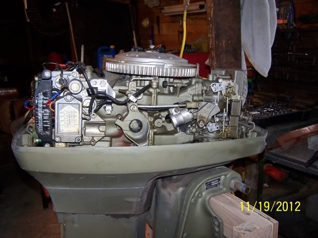

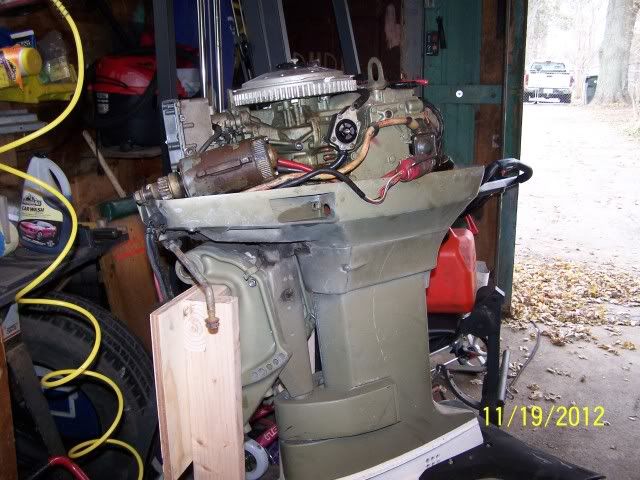

Thought I would start a new thread as the other issue has been resolved. Thanks everyone!
1st the pictures.
Now for the story. This is a 1975 50hp Johnson that I've picked up to go on to my new project Alumacraft Classic 16. Found this while looking at another engine that was posted on craigslist that wasn't quite what I was looking for. When the guy told me he also had an old looper for sale we went and took a look. He also told me that he didn't know much about it as it came off a boat that he'd scrapped. How long it has been sitting is unknown.
So I first did a compression check that revealed 150psi on both cylinders which I was completely suprised and proved promissing. Next, checked for spark and there was none on either cylinder. Sad but not disappointed. So I went home to ponder this thing and decided why not if the price is right.
Is $100.00 the right price? I thought so.
Got it home and connected a start switch and battery and had spark for a bit and then it quit again. Over the weekend I went through and checked all the wiring and connections and couldn't find anything broken or loose so I tried it again and it now has beautiful spark on both cylinders.
Today I thought I'd give'r a go and see if it would start. Nothing. No spit no sputter, nothing. Then pulled the cover off the fuel pump and it was dry as an old bone. Tried to pump some fuel through it while the cover was off and still nothing. Pulled the hose apart and the end to the pump showed cracking and the hose was dry. Next came the hose connector at the shroud and discovered that it was completely block.
So that is were I am at with this so far. Tomorrow it's off to get some new fuel line and maybe a couple of carb rebuild kits. Then I'll see if the monster lives.
