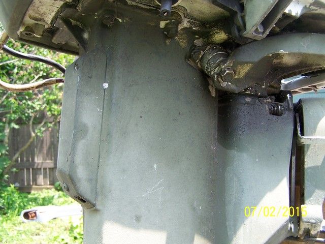

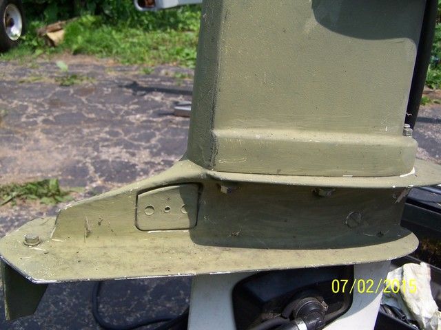

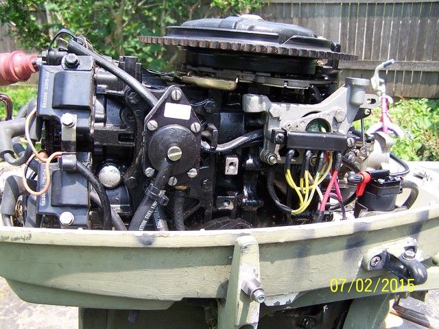

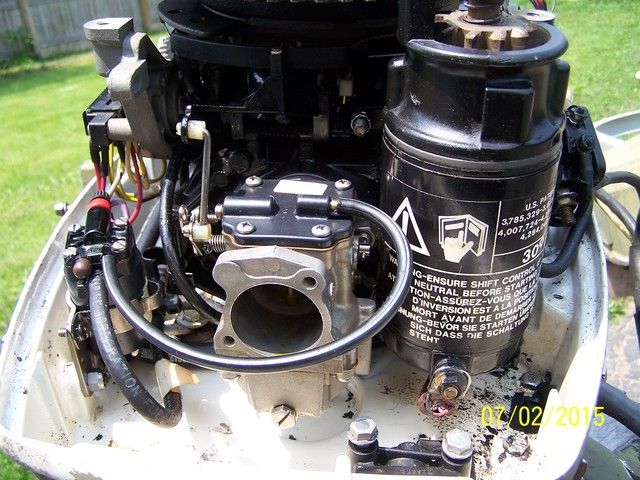

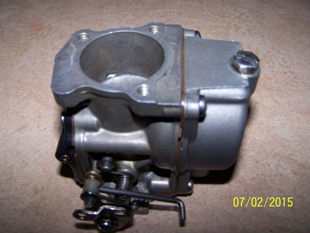

I think these pictures hold the biggest clues. The carb with the plastic cover, the anode, the extended pc on the mid-section for the exhaust. Once again have searched thru BPR and can't place this. I do also have a few casting numbers if anyone would think it will help.
39,240
Is there a number on the round disc near the fuel pump ?-------Based on info from pictures it is a mid 1990's model or even newer.

Yes there is a number in that welch plug. It is G3517526. Was told by the owner of the shop that I've been using for years that on the newer engines that number would be a serial number and that BRP doesn't give out that info any more. But he did suggest that if I bring the carb to him that he may be able to ID it. But again no promises.
As I understand it these lowers disconnect thru the water intake. Will have to check that though.
Looking again last night the 1995 carb that matches the closest on that engine the 35hp uses 2 carbs, so I guess that eliminates that one.

Next clue I have is that the primer is mounted to the side of the lower cover and not to the fuel bowl.
