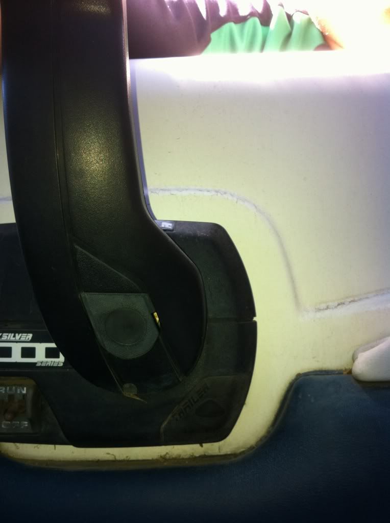

ok guys here we go, my first question is in the picture below there is a button under the throttle on the right side. it says trailer i want to know what this button does, also on the left side of the photo there is a a run/off switch. they just told me to have it on run obviously when im going to use it. just wanted to know exactly what this switch is for. thanks

The "Trailer" switch will lift outdrive to its highest position for trailering. When you are running on lake, you can only trim the outdrive to about 1/2 its highest position or it puts undue stress on u-joints connecting motor to outdrive. On our '02 Glastron, I could only trim to about 1/4 and the prop would "blow out" or start spinning like a car losing traction. Sometime the "trailer" position is also called tilt. (I think I have the terms right :) )
The run/off switch is for a lanyard that would clip to your person when operating boat. If a wake/wave bounced you bad and you fell down losing control of the boat, the lanyard would pull lose and kill engine. You can buy replacement lanyards but there are few different styles to connect to the kill switch. It is a safety item that you choose to use or not. I'm bad and have rarely used it with the Glastron. Since I stand and drive the Tidewater more, I do use the lanyard more.

That "button" on the outside/bottom of the handle is used to dis-engage the drive so you can prime the carb and put it in high idle for starting a cold engine.
Just push that button in with your left hand and hold it while you actuate the throttle forward 3-4 times and then leave it in the half **** forward position. Turn engine over until it starts and let it run that way for a minute or so to warm up. When your ready to go, bring the throttle back to center/neutral position.;)
