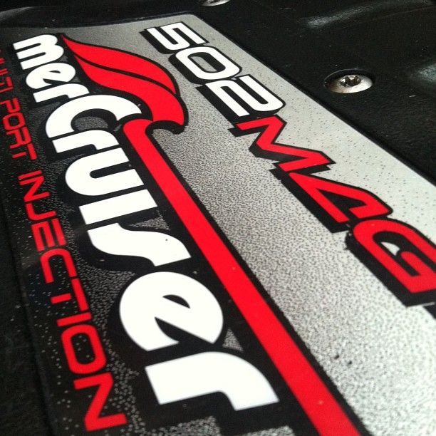

so last fall I traded my motocross trailer for a 1992 Rinker 236 Sport Cuddy. I've been on my in-laws' boat for the last 10 or so years, but now that my wife and I suddenly have two kids under 2 years, we realized it was time for our own. I ran it for 10 minutes before it was put away for the winter last year, so the "official" mayden voyage was Memorial weekend this year. Anyways, here are my questions.
1. would this have come with the MPI fuel injected 502 its equipped with? seems like some others i see of this year had 502's, but usually carbuerated.
2. i've found a couple merc service bulletins online stating where i can find the serial number on the engine, but i cannot locate it. closest i've come is a casting number on the rear of the block.
3. my main reason for coming here. this boat starts, idles, and motors along great... until you open it up full throttle, at which point it blows oil out of the intake all over the starboard side of the engine/compartment. first notion is massive blow-by, but i'm wondering (hoping?) it has something to do with the way the PCV system is set up. instead of having a PCV valve between one valve cover and the intake manifold, and another vent tube from the other valve cover to the flame arrestor, BOTH valve covers have a PCV valve on them (with different p/n's on each), and they are T'd together and running into the intake manifold.. leaving the flame arrestor port unused. i've been up and down the internet understanding the PCV system and looking at alternative setups and i haven't seen this particular one.
is there any chance thats my problem? is the vaccuum inside the intake manifold at full throttle pulling oil out of the pressurized crankcase?

You stated the boat has a carb, with a carb it is not an MPI. It may be a 502 but in 1992 I don't see a MPI in the mix. The serial number is un the plastic flame arrestor cover but it sounds like you don't have one. Look above the starter there should be a plate there. If you do have the casting number let us have it and we can look it up.
The PVC systems would not be causing excessive oil blow-by, the PVC setup is to control blow-by. ~~It does this by allowing the carb to suck the oil fumes back into the engine. I am assuming that the oil is coming out of the valve cover tube and with that your engine probably has some bad rings. You have the right first choice in doing a compression test.

thanks for the welcome and response AllDodge! but i didn't state my boat has a carb.. it's definitely MPI. that's why i question the originallity of the engine in it, the boat being a '92 model year.
I know the current PCV setup isn't -causing- blowby persay, just thought maybe it was sucking oil since both are T'd together and running into the intake manifold, with no fresh air supply, creating a vaccuum in the crankcase when running WOT.

Sound like the PO was trying to take care of his blowby problem by adding the 2nd pcv. Problem is, at WOT there is no manifold vacuum and that's when the blowby rears it's ugly head

I have the same engine in my Cruiser but my hoses do not have PVC valves in them there just open connections. The difference is my hose does not connect to the intake, it has a short piece of hose which sits just below the flame arrestor. See item 30 and 31 in the link below
http://www.mercruiserparts.com/Show...&bnbr=20&bdesc=CYLINDER+HEAD+AND+ROCKER+COVER
In the link above mine has another hose which connects to item 29 so both sides breath. I do get some build up under the arrestor so it needs to be cleaned every once in a while. So with oil being only all over the starboard side I take it, the oil is blowing out of the tube on that side? Guess you could plug the manifold connection and run straight fittings so anything that comes out would be pulled in as mine do, but looks like your arrestor has been removed. The 502 is known to use oil but yours is building up some higher then normal pressure in the crank case.
that was my notion too. i thought i read that if the blowby is really that bad it will puff vapors out of the valve covers even at idle if the oil fill cap or pcv valve is pulled out, but its much the opposite, plenty of vaccuum.
bbender785
Jun 2, 2014
23
..So with oil being only all over the starboard side I take it, the oil is blowing out of the tube on that side? Guess you could plug the manifold connection and run straight fittings so anything that comes out would be pulled in as mine do, but looks like your arrestor has been removed. The 502 is known to use oil but yours is building up some higher then normal pressure in the crank case.
its actually coming out of the flame arrestor (which i have & use, but is removed in the pic i posted). i know its hard to really know until i get some compression/leakdown numbers, but in the meantime i'm theorizing. think i'm going to run a catch can setup regardless.

Is your flame arrestor plastic or metal? sounds like and kind of looked like you would have had a plastic flame arrestor from the photo. Also for your fuel pump, do you have a fuel vapor separator tank near the rear of the engine or do you have a fuel cooler down under the port side motor mount? In 1997 Mercruiser started using plastic flame arrestor and closer to 98 they went to the cool fuel system. You will notice most of the serial number breaks in the link below. Between the two serial number breaks, It should help with finding most basic parts since you can't determine the year. Also a photo of your ECM and an over all photo of the engine may help tell a story as well. Sometimes you can find a serial number on top of the electrical box and a white sticker around the flywheel housing area. While you may find a few "test boats" from late 1992 with 502 EFI's in them, most of the 1993 + boats would have a 502 EFI in it as standard.

the housing is plastic. would that be a black and white indicator of a 97+ engine?
