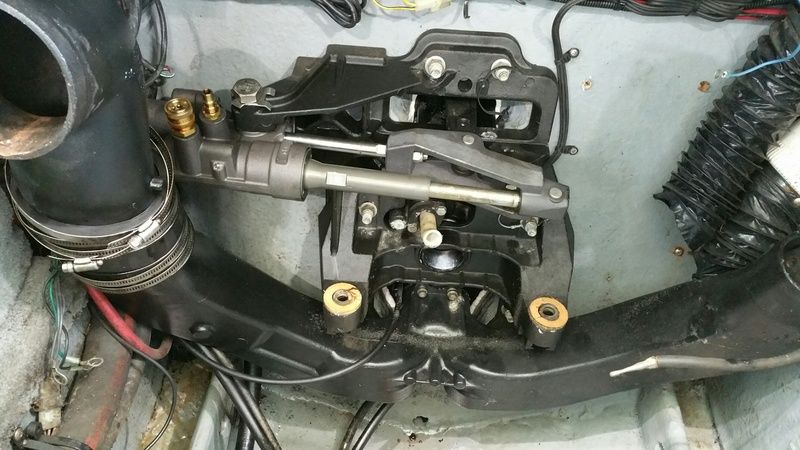

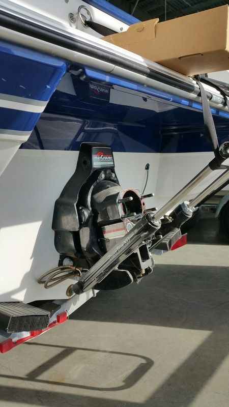

I have a 1992 Four Winns 195 sundowner ? In MINT condition (100hrs one owner) HAD the 4.3 Mercruiser

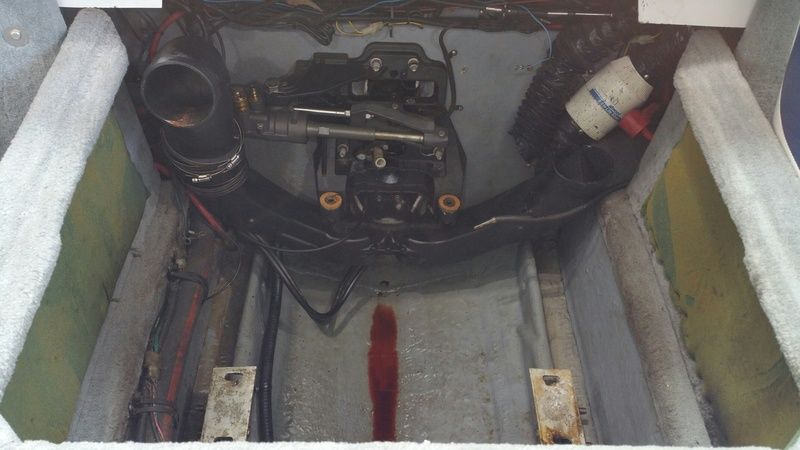

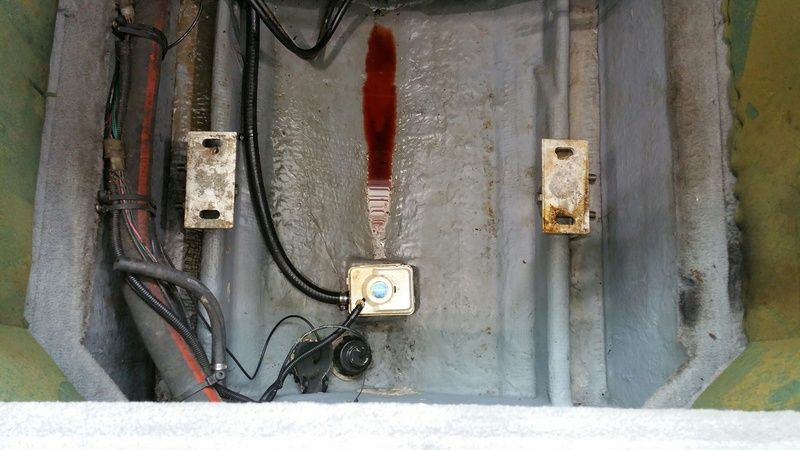

No motor or outdrive just transom/steering stuff left

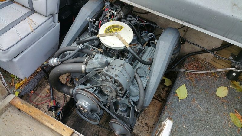

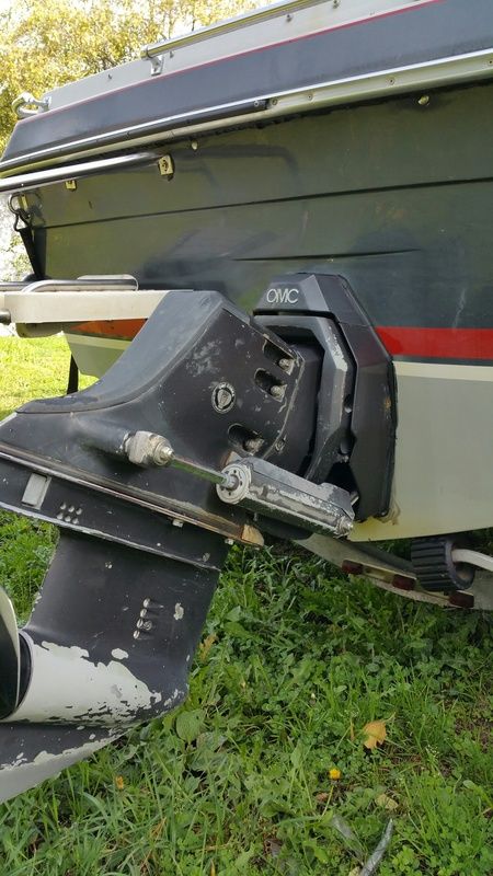

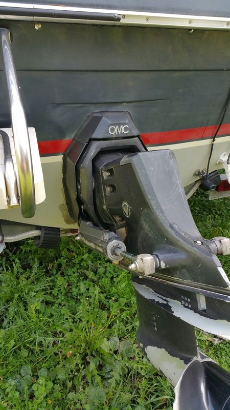

I Also Have a 1987 Marlin with a freshly rebuilt 4.3 OMC and cobra outdrive ? (Hull is cracked from a rock underwater)
My questions are ??
Can i transfer the whole OMC/Cobra setup in the Fourwinns?
Will the OMC 4.3 bolt up to the mercruiser transom assembly?
Can I run just the OMC 4.3 motor and buy a mercruiser outdrive?
How much work would it be to use just the OMC 4.3 engine or the whole package in the Four Winns boat ?
Should I just sell the OMC motor/OD and buy Mercruiser motor/OD ?
So Long story short we cracked out boat (1987 Marlin) this summer but last summer we rebuilt the engine including new block etc so the motor is strong and has maybe 40 hrs on it ? Also the outdrive works great ? the whole boat has 250 hrs on it .. (rest of the boat is a little rough)
So I set out to look for a boat with a bad motor or no motor and found a Cherry 1992 Four Winns 1992 Sundowner ? one owner 100hrs super mint inside and out ? 2003 dual axle galvanized trailer in like new shape ? The problem is it had a 4.3 mercruiser and merc outdrive ?

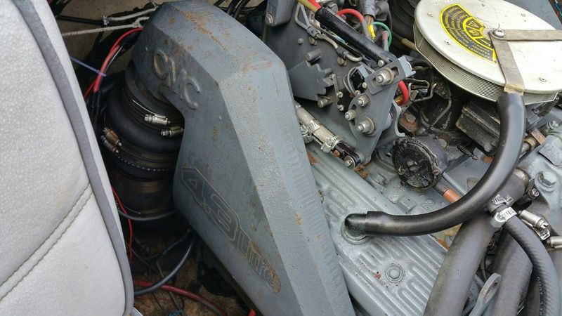

The 4.3l long block will be the same. It is the externals that are different.

I would say use the 4.3 liter you have and buy the necessary Mercruiser parts. Then buy a new SEI outdrive and install it. That's a nice boat - in good condition for the age.

Agree with Fishermark, also those bat wing exhaust have had issues. OMC parts are getting harder to find, you still can, just not as many sources. Also take a very nice newer boat and put an OMC on it will kill resale value.
I would try to find a donor boat or motor and that way you can use the long block from the OMC and put Merc exhaust and other items back on it.

Guess need to ask the OMC folks to see if the OMC hole is the same size or larger then the Merc.
Here is Merc
I found this but do dimensions

I still have all the merc transom/steering stuff in the 1992 sundowner so thats good ?.
