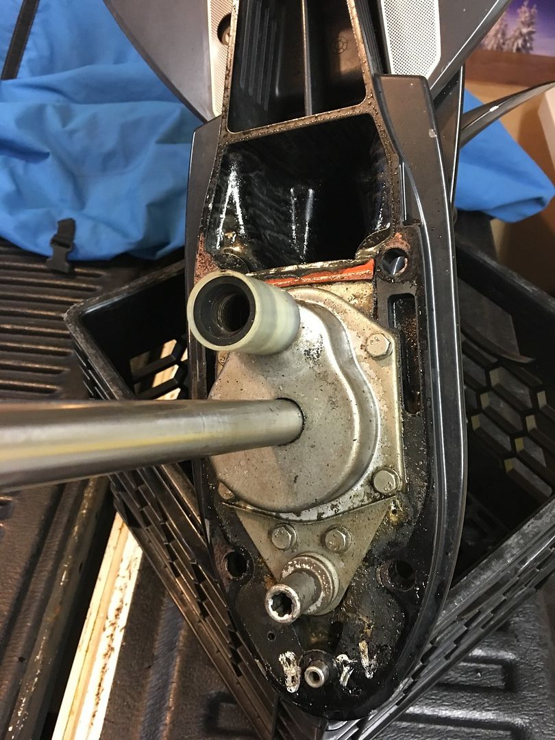

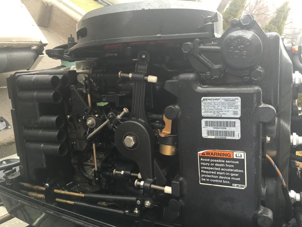

Well guys I found the reason why the tell tale is not showing itself.....I brave the cold and 30mph wind gust...the local shop was amazing to help while the other one well.......yeah. So pics to follow!
Everything looks fine so far!
The turbo model maybe? (The guy selling the boat had the hose for the muffs hooked up to his hot water heater, the water coming out was too hot to touch)
Theres actually burrs on the inside of the housing!
Doesn't look like this has been done in a while, or has been and just not cleaned up at all!
All cleaned up and awaiting the new parts to come in!
The local shop I went to order the new parts and beat any price I could find online. The refused to order parts until I brought them the old parts just so they could confirm the right parts were being ordered due to a No Returns on Parts policy!
Since everything in the water pump area that was supposed to be as clean as the rest of the boat looked horrible, I also decided to get a new thermostat and seals for that right away too. This way I know its new and all is good!
Thanks for all the help! I am sure there will be more post soon in other threads! Especially since the boat has a anchor winch and I would like to add a remote switch in the console for it, and I would like to put a new "fish finder/chartplotter" on the console!

That happens when people start them out of the water. You see people do it on the launch ramp before they put it in the water to see if it starts. That rubber impeller riding in that metal housing melts right away. In other words if it's not wet then don't try and start it. Ever.

When you have the t.stat cover removed, I would flush it from the top. Bits and pieces from the old impeller find their way into water passages. You might end up pulling the cylinder head and going after the stuff, but I would try flushing it and then see how it runs when it's back together (check temp.). JMO.

pretty straightforward. While the l.u. is off and the t.stat cover removed, use a hose at low pressure to flush from the powerhead. You might use the male end of a quick disconnect, for example, for a fit up there -- but doesn't have to be tight. If it were mine, I would flush up from the bottom as well, maybe using a piece of fuel hose or something similar to get some water up from the bottom. I have a number of "specialized" tubes and hoses that I use when working on one of my motors. It's particularly useful for salt water motors, although from your pic I'm guessing that might not be you. Flushing might be a spring project.
ford84
Feb 23, 2016
21
So basically take the thermostat out, shove some type of a fitting in the hole, turn the hose on, and let it flush out for 10 mins or so?
