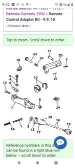

This is the adapter kit for the 9.9 rude remote. Is it any of these parts?
bigjon69
Dec 11, 2024
#1 and 14. Instructions say screw in to threaded flange under stator plate, along with a really bad picture. I have everything from that kit except the kill switch.

look under the stator plate, should be a tab with a threaded hole in it. You have the harness off of a larger engine. you probably don't need the purple wire.
