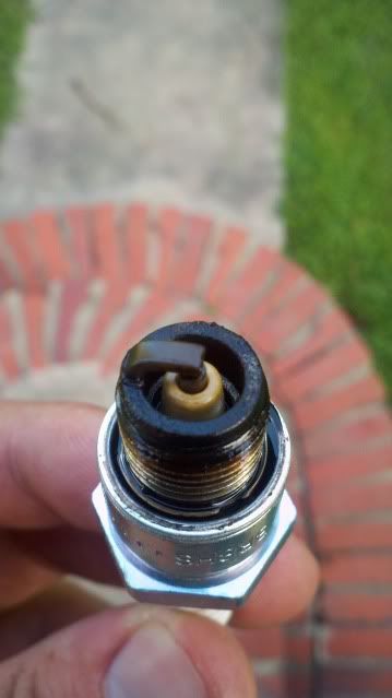

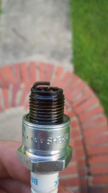

carb parts are soaking except the floats and plastic parts. here is a plug i pulled today. plug is a little under a year old with prolly less than 2 hours on it. also pulled the fuel filter which has been pulled recently and there was some small amounts of trash in there that just got in there recently.
