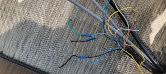

Attached is a picture of the wires coming from the remote. I see a gray wire for the tach but I don't see a tan/white for the tilt. Maybe the purple/lt blue or tan/blue stripe?20220605_140038.jpg
