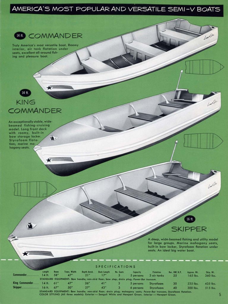

I am new to boating. I have a 1956 Lone Star King commander with. 25hp Johnson 2stroke and I need to find out the weight of the boat??? I've tried to google it and can't find it anywhere please help thanks

The Fiberglassics 1956 Lone Star factory spec sheet has two Commanders listed, one with a 58" beam and one with a 61" beam. The narrow one is 165#, the wider one is 235# - Both are dry weight for a bare boat, no motor, batteries, fuel, etc. If you can find the model number, the narrow one is 171L50 and the wide is 210L00. Often stamped near the transom, sometime on the knee brace. Guessing the wider boat is a "King Commander"
