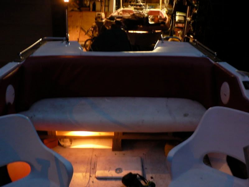

well heres the radio installed... the fuse said 5A .. i ran it right ot the battery.. but will change it later on .. the only thing running straight from the battery right now is that.. the vhf and than the bilge pump.. the vhf i never have on cuz i still need an antenna.. so i think i shoulud be good for now..
how long can i run the radio without have to start the motor and charge the battery for a while?

If you are just running the radio, you can run it all day w/o an issue. It will only draw a couple of amps/hour, which is nothing to worry about.
