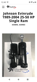

The 48 special was made to be cheaper...that's what "special" means I guess. I looked at 50 HP in that year and couldn't find any new ones just parts. I did find this company (not sure their real) and they rebuild them. 1st picture is what I believe is the one you would want and the 2nd link is there home page. Call them and maybe they will know more info.... possible able to rebuild your assist ram or get you the part number to the power t&t and you can look online for a used one. Hope this helps.
