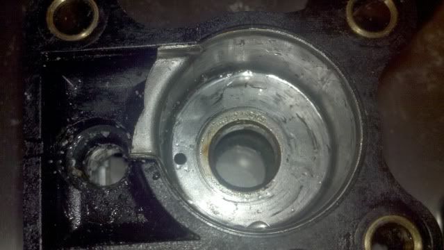

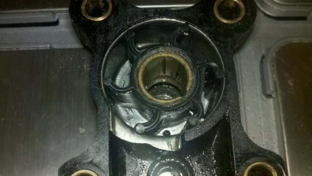

finally had some tme to get back to this motor
I went to change the impeller tonight and when I flipped the water pump housing over I see this
My question is.Is the bare metal area normal at the rear of the housing or ?? I havent been able to find any pictures of the UNDERNEATH of the waterpump housing

Looks normal to me if its a bit set in. I don't see why there would be a seal there.. it doesn't look torn, but I'm no pro maybe someone else can concur. Nice looking impeller though. I've seen the vanes bent in all different directions.

Re: My 84 Rude 15hp bargain motor. Going to need help
hi.
jest its normal look inside.
inside there is NO seal at all.
top of impeler is presing to this metal cup and acts as a seal.
but if you turn out the water pump housing(you will see water pump outlet and inlet for drive shaft), there is seal where drive shaft enters to housing.
this seal is important

hi.
Thanks for the reply, I do know there is no seal inside the cup o this side.
I was curious about the "lip" of metal toward the rear but have since found pics and this is the way they are.
