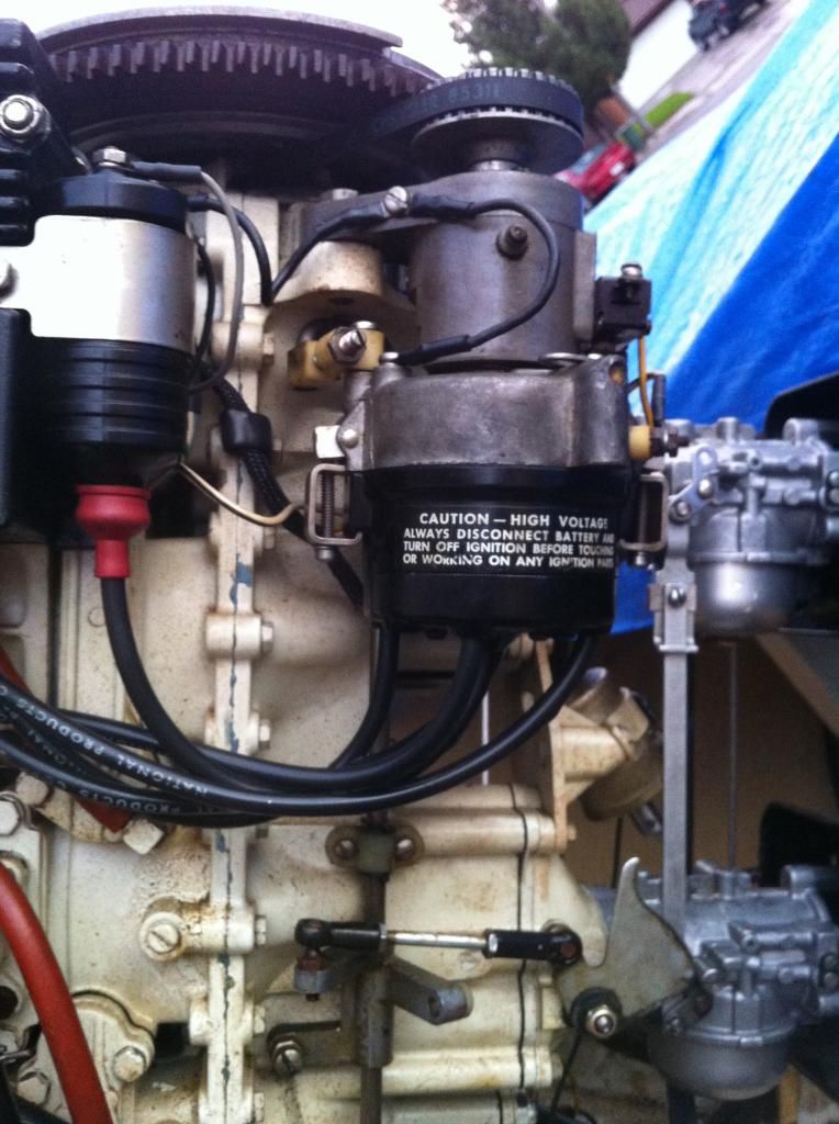

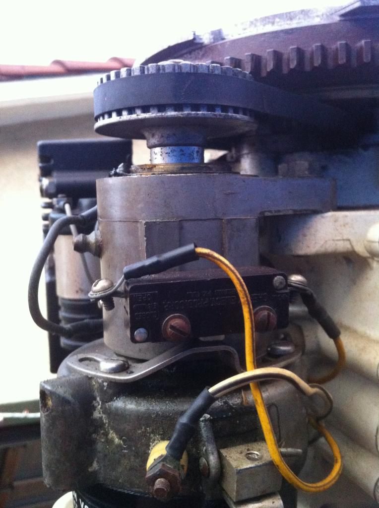

I got a break in the weather
Here is a picture of the distributor:
Here is the front top:

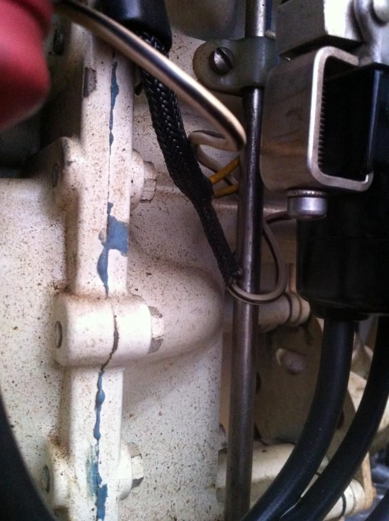

Here is a wire that seems out of place, but I am not sure if it will make a difference, this is below and behind the distributor:

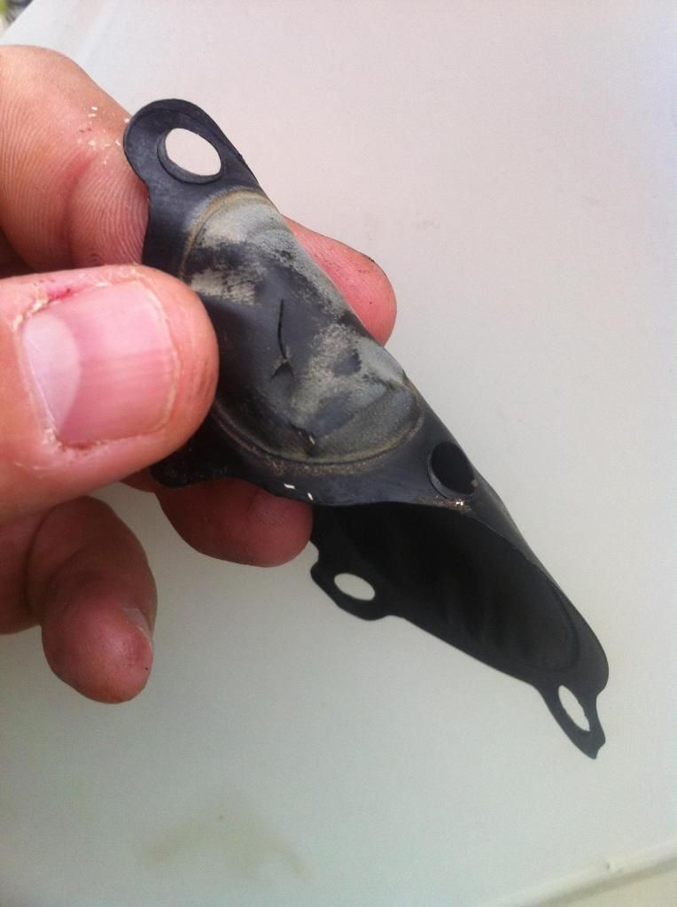

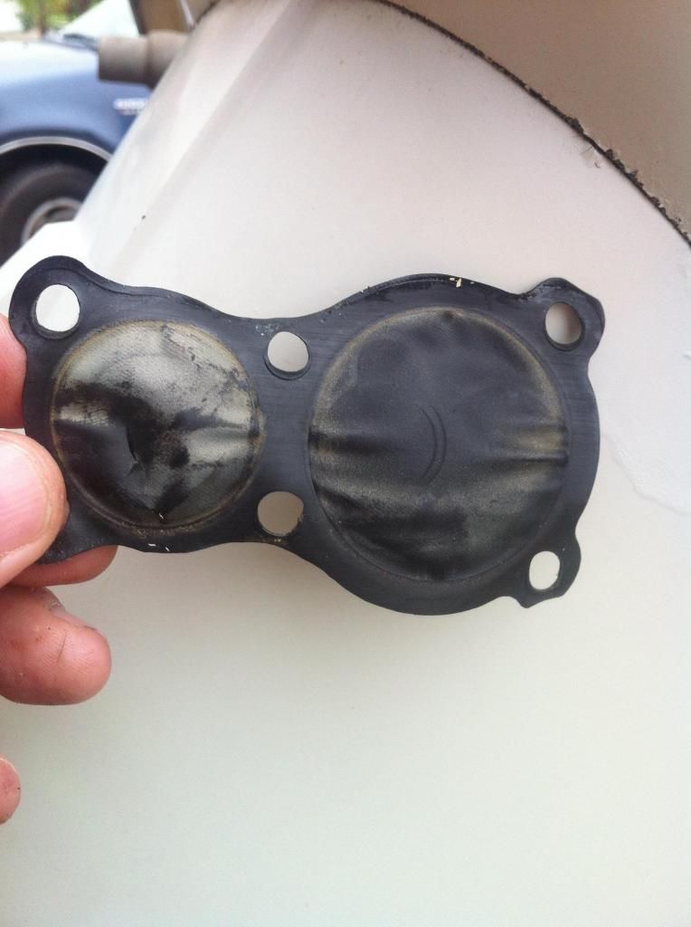

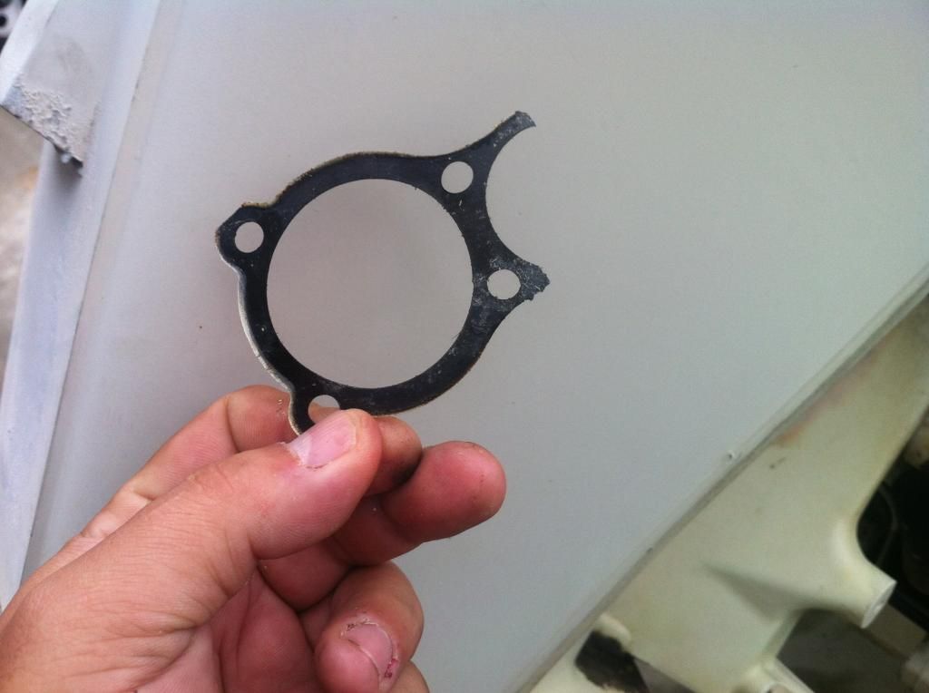

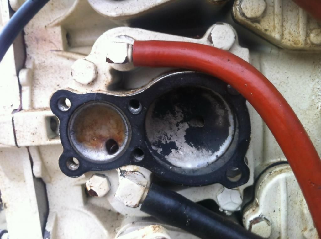

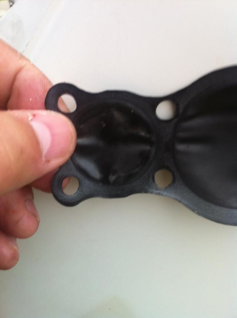

I took apart the fuel pump and the diaphragm was a mess...
Here is the guts shot:
This is what came off of the diaphragm without effort:
Here are both sides of the other piece that goes inside there with the diaphragm:
There is a hole / crack in smaller side:
I am ordering a new one of those as well.
Will that have an impact on my fuel consumption?

Re: My 130 HP outboard is drinking gas!!
Ah, yes. You have an older Chrysler with a Motorola electronic ignition and points. Points are set to .010. That engine also has the neutral interlock mounted on the distributor (which Coast Guard at a later date changed requirements to the placement at the shift linkage. It is grandfathered but no longer considered as safe on more modern engines.).
In the photos, the two yellow wires are the start wires, coming off the neutral interlock switch. The white with black trace is the signal wire from the points to the CD box. It is not out of place. In your case it wraps around the timing tower then goes up to the back of the CD box. When the points close, they go to ground and the transistor inside the CD box senses this. It then dumps the capacitors into the coil, causing spark.
Obviously, with the crack in the second stage of the fuel pump diaphragm and the broken gasket, not only will the engine drink fuel excessively, but performance at all speeds will suffer
