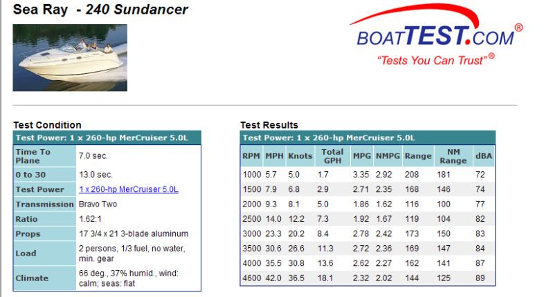

Which of the following is the best cruising speed for a 24' Searay with a 5.0L, and what is it's range? Which one has the best chance of getting me to the next fuel dock 130 miles away?
7.3 GPH at 2500 RPM
8.4 GPH at 3000 RPM
11.3 GPH at 3500 RPM
13.6 GPH at 4000 RPM
No way to tell just from GPH.
45Auto
May 31, 2002
2,842
Re: mpg
The answer to the post above is the Searay 240's best cruise speed is 23.3 MPH at 3000 RPM. It should be obvious if you look at the MPG column in the chart below which is for a 5.0L fuel injected 24' Searay. In reality, anywhere between about 23 and 35 MPH will give you almost identical fuel economy. Notice how GPH is irrelevent to this and hasn't even been mentioned? You could leave the GPH column out of the chart and it wouldn't make any difference to the discussion.
If you don't understand the relationship between fuel consumption and speed, the chart below will be pretty much meaningless to you.
To the original poster, I would figure on somewhere around 2 MPG depending on the age and load of your boat.
And the MPG with a full tank, a lot of gear, more people and against a strong current in heavier seas would be ????
Your assessment or should I say the boat testers assessment was in calm seas with no wind and did not give any variation for differing conditions.
Guideline for me would include the GPH column and the RPM. Anything else is a huge variable.
Does your tow vehicle get the same MPG going uphill as it does going downhill ??? Do you get the same MPG towing your boat as you do solo ??? then there is the variable of going uphill towing your boat uphill ??? the sea conditions, and loading will give the same variables.
