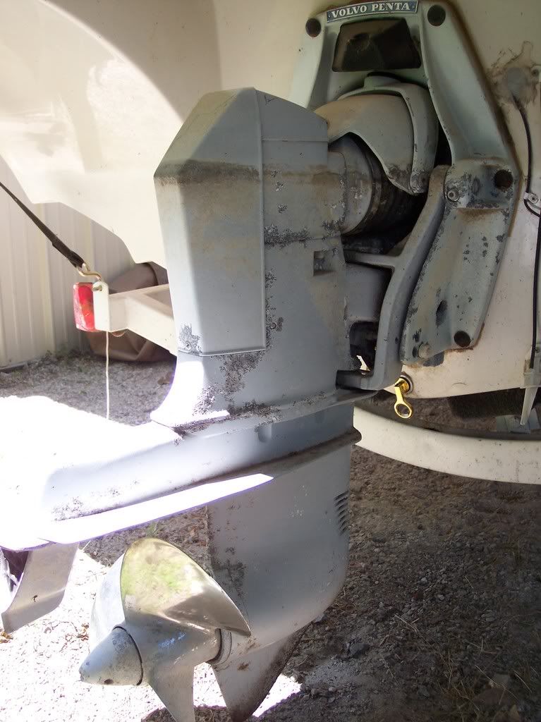

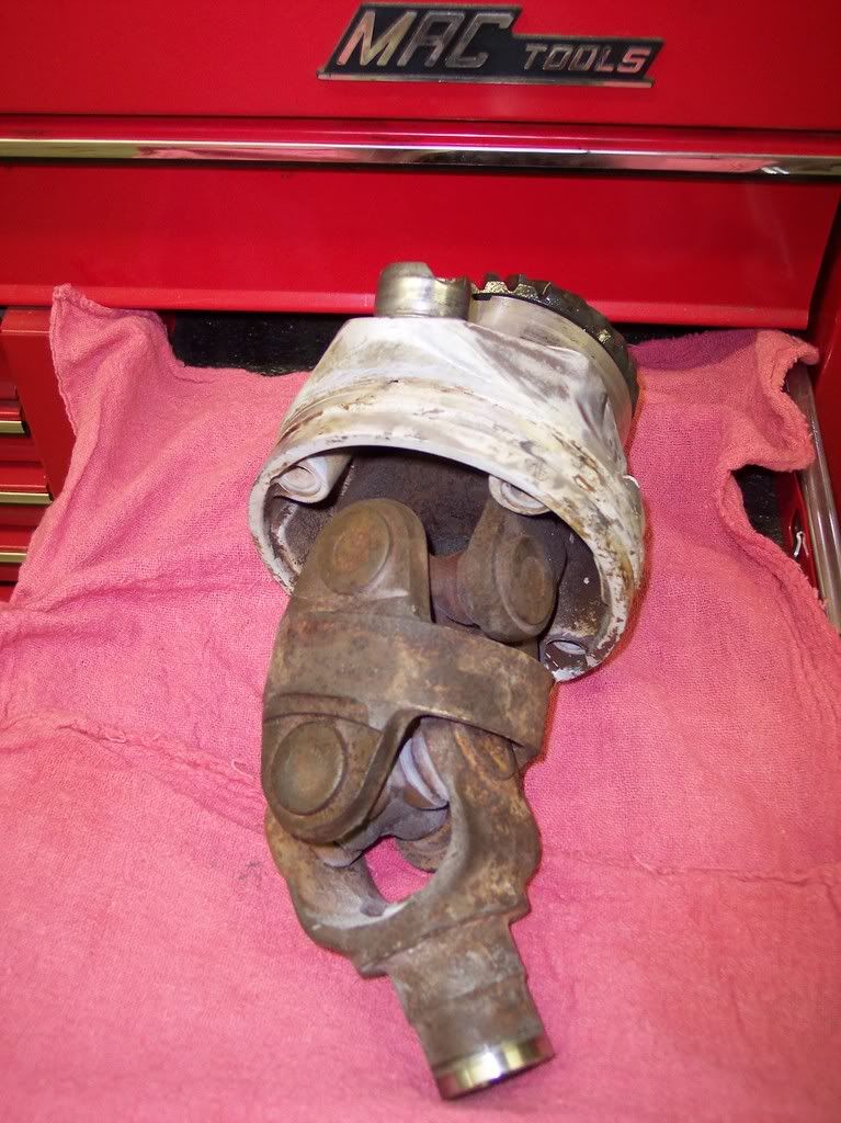

I am working on a 1988 volvo-penta AQ 131D with the SP-A outdrive. I have a decent amount of skill, and I am wanting to replace the u-joints on this unit. I have the sterndrive removed, and I have the u-joint shaft and bearing housing/plate removed. If I remove the bolt that holds the gear to the shaft, am I disrupting the bearing load. This bearing looks and feels fine from what I can see and am not planning on replacing it unless absoulutely neccessary. Can I simply unbolt the gear, pull the shaft, replace the u-joints and torque the bolt back to 90ft lbs. I have a clymers manual and they show a string wrapped around the gear and pulling on it to measure preload on the bearing, is this necessary using the old bearing?? Hope this sounds clear enough, sorry to ramble and truly appreciate any advice and help I receive.
I've attatched pictures of what I am working on.
