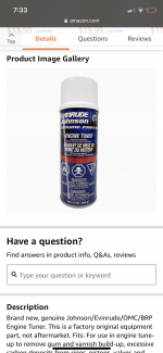

I had just bought the gauge prior to doing the test so I don’t think it’s that. While I have the head off, I inspected the cylinder and cylinder wall and did not see any gouges or scratches in them. This motor was pulled off a old project boat and had been sitting for a while.I am going to get some engine tuner and spray it in there And see if they can break down any carbon buildup that’s on the piston rings and bring the compression up. I have read great reviews over the Johnson and Evinrude engine tuner spray and will try that before breaking the motor down. Has anyone else used this product?0EF0861A-802B-44F4-A16F-EEB75E9B568B.png

I had just bought the gauge prior to doing the test so I don’t think it’s that. While I have the head off, I inspected the cylinder and cylinder wall and did not see any gouges or scratches in them. This motor was pulled off a old project boat and had been sitting for a while.I am going to get some engine tuner and spray it in there And see if they can break down any carbon buildup that’s on the piston rings and bring the compression up. I have read great reviews over the Johnson and Evinrude engine tuner spray and will try that before breaking the motor down. Has anyone else used this product?View attachment 330367
Well, I sprayed this in directly through the carbs throats while the engine was running just as suggested then let it sit for about 30 hours and ran it for 10 minutes or so at slightly above idle and redid the pressure test. Pulled all the plugs out and it brought the previously 70 psi cylinder up to around 85-87 psi, and the other previously 90 psi cylinders up to around 93-95. So now they are all within 10 psi of each other. I changed the plugs and I put it in a bucket to test it with some back pressure and it seemed to have improved drastically. Will take it down to the river tomorrow to see it it’ll idle good at the dock.
