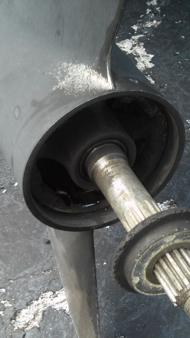

Here is a picture of the prop shaft with the forward thrust washer pulled out some to expose more of the shaft.

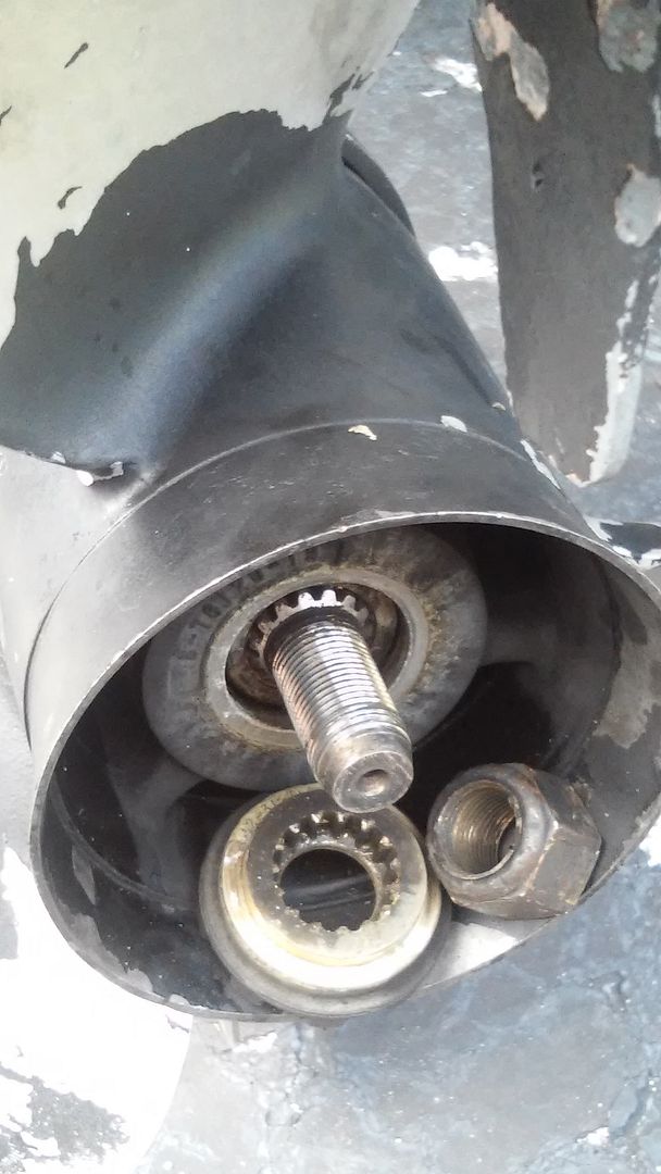

Here is a picture with the forward thrust washer in place with the prop on. Notice how the splines on the shaft barely protrude so the rear thrust washer (splined washer) will not seat on the shaft splines. That splined washer and nut were the only things I have on there after the propeller. The spider washer (or lock nut as I described) is missing.

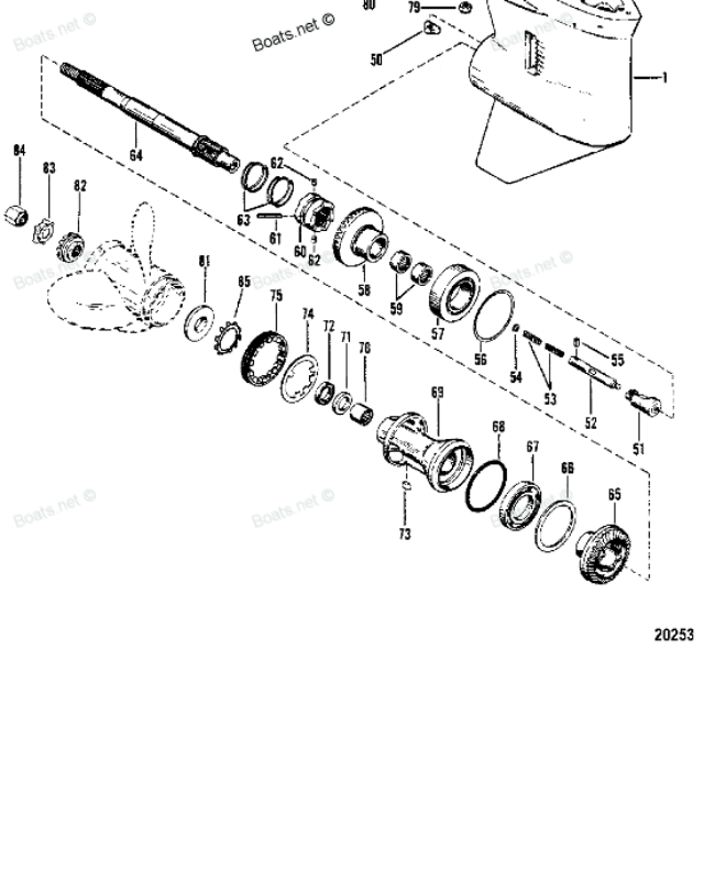

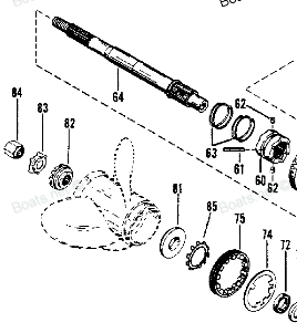

I tried to blow up this pic as much as I could. I am missing number 83(the spider washer), but 82 looks pretty similar to my rear thrust washer which has splines. I can't find any better diagrams on this old motor.

Number 81 is the thrust washer. From your picture, the one you are using is splined, like number 82. Number 81 is not splined, but is ground to match the taper of the prop shaft. That is the one you should be using.

I have 81 and 82. This may be a little confusing at this point, but I've referred number 81 as the forward thrust washer as it sits in front of the prop. It can be seen in my first picture really well. The first pic has the prop pulled off and #81 (the forward thrust washer) is pulled out some sitting on the splines for better visual. The next picture shows the propeller back on the shaft and #82(rear thrust washer) and #84 as they both go on after the propeller. I haven't had a chance to take the boat out yet to see if tightening up the prop makes any difference toward my original problem with the bogging and surging. Also still confused why my splined washer doesn't contact the splines on the propeller shaft.

well, there are different thrust washers for different props. The diaghram you posted is likely for Merc props only.
FWIW, the thrust washer in the first picture is unlike any I have seen before, and I have had Mercs going back to 1973. I think you should get a new one.
