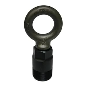

I got one down at my local boat shop for $32.00, it lifts anything from a 30hp to a 250. They had it in stock and they're a small shop.
