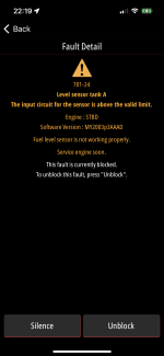

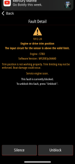

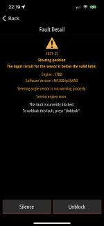

Hi. These are standard inherent errors shown for sensors that aren’t fitted or applicable. These show up on vessel view on my mercruiser mpi. Saying that, the sea water temp might not normally be there. I’ll post a picture of the ones on mine below. They are blocked.
Sw isn’t there. Might need to look into that.
