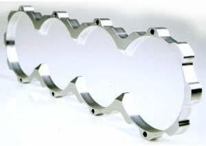

The problem is with the free standing cylinders that have no upper support.
agreed, floating bores (AKA open deck architecture) suck
which is why I recommend a bore stabilizing spider, AKA Deck girdle if you plan on getting longevity out of a floating bore motor
like this
or this
