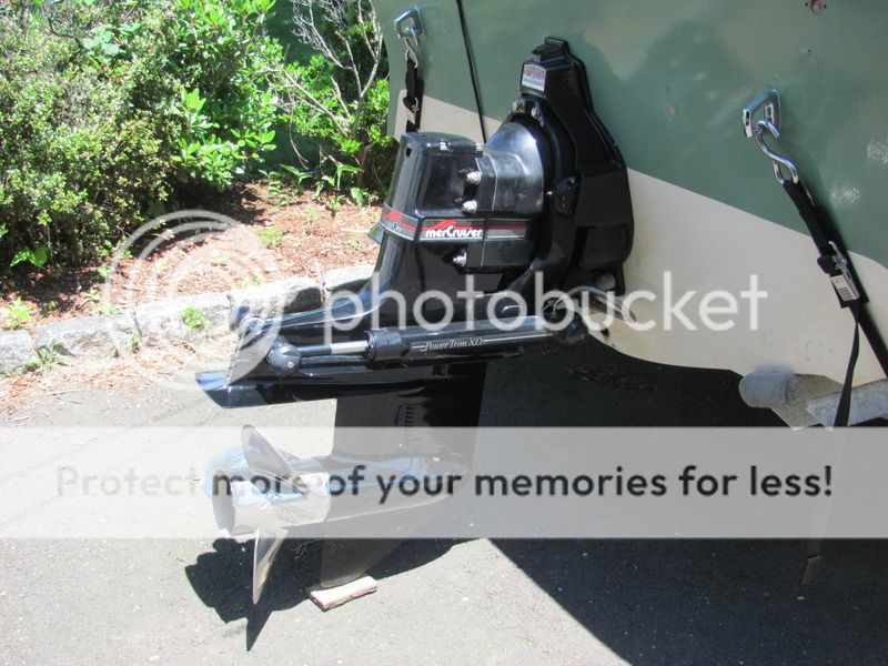

OK, the only '255' GM engine used by Merc with a sterndrive was a TR.
Here are pictures of the different drives.
This is a TR (Note the bolt-on cover on the back of the drive)
Here is a R/MR/Alpha drive. A lot smaller and lighter. (and no bolt-on rear cover).
And finally a Mercruiser-1 drive. (note the lifting eye on the top cover)
Alpha and 1-drives select the gears internally (on the propshaft). TR drives require a transmission behind the engine.
