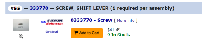

Changing out my gear lube oil and ordered new screws to replace my almost stripped ones. Come to find out the lower screw for my make of engine listed in all the schematics is not the one on my engine. The top drain plug I received is correct but the bottom one is not since its Threaded on the inside. I cannot find this one anywhere since every site lists the one I ordered for my model engine. Anyone know what this one is? Or where to find? Pics included. Motor is Evinrude.. Model E50TSLECC. Thank you!

#10 is your lower drain plug screw, not # 55
You can buy sierra 18-4249 drainscrew that has an allen head to replace it so it doesn't strip as easy in the future.
#55 is shift lever retainer screw not a drain plug.

The bolt you removed probably locks something into place. I would wait for one of our experts to post before you touch anything else. Hopefully you can just put it back in.

Ummm,....that's the screw that holds your shift rod in place. I'm sure someone has told you this at this point. Hopefully it will line up and go back in and you haven't screwed up too bad! There is an o rings that goes on that screw to seal it. But it has nothing to do with gear oil change in the bottom.

did you unscrw the wrong part see diagram oil screw plug is common e/w magnet below yours...see#10 just under yours
