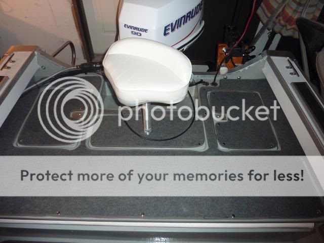

if there is anyone that has tried making one them self ?
If you have, please share any ideas.
Hey Pat, here's what I built:
Full deck, fishing mode...
Flip up the seat, cruisin mode...
