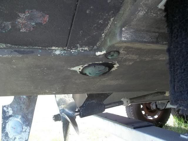

I am not wrong for my setup, nor the OP's if he has the same setup.
Here is a pic of my livewell pickup.
Through the transom without a scoop and a strainer only.
If the Op has the same setup he will have problems trying to fill the livewell at speed while underway.

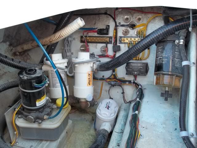

Damn, you bass fishermen need to get some serious livewell plumbing! Here's a typical "scoop strainer" pickup on boats down here in FL, this one on a Pursuit 26, feeds a Rule 1600GPH single port pump (the mushroom next to it is for the washdown pump)...
...and here are 2 REALLY high-speed pickups, transom mounted as this is on a Talon F-20, and the boat's bottom needs to be kept "clean". They feed dual 1100GPH Bait Sentrys, the starboard one also feeds the washdown from the lower port...

THANKS to everyone for taking the time to respond. My pick up tube is thru the transom with no strainer, extends maybe two inches straight from the hull and is very near the prop. I do not have a recirculation pump separate from the livewell pump itself. Wonder if I put an elbow on the pick up tube and extended it toward toward the edge of the boat ?
