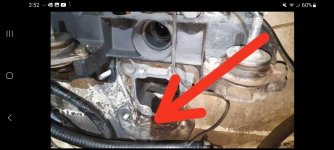

Hit some rocks the other day with our 1989 OMC Cobra with 3.0gm. I now have water leaking from the area on the photo. Outdrive is fine and boat still operates fine. Probably needs allignment too.

Being a 1989, you may find the transom is rotten and the rock hit just mashed in the rotten wood and the transom thickness is no longer sufficient to keep the gasket compressed
