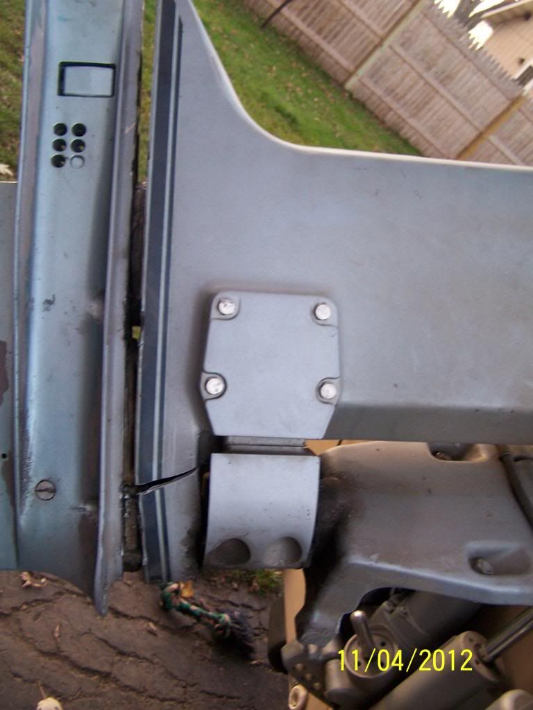

Well the boat was brought home Saturday and I not sure how I want to proceed.
The shaft is really siezed in there and when they tried to remove it they must have stuck pry bars into it and really reefed on it as the exhaust housing has 2 large cracks in it. Also there is not enough seperation between the lower unit and exhaust to try and spray down the dive shaft.
So, do I just junk/scrap/salvage what I can? Do I try and repair it? As-is it is useless.
I have thought about removing it and as the exhaust housing is already trashed just taking a saws-all to the exhaust housing and cutting it off to get access to the shaft and then trying to remove the shaft. Then if sucsessful just looking for a donor motor to cannablize parts from.
I believe the engine it self is functional as while cleaning out the boat I found a brand new in the box water pump kit and I don't believe they would have purchased it if the motor was not running.
Opinions and thoughts please! BTW thisengine is equiped with PTT.

The cracks in the exhaust housing may be able to be repaired (welded).....the suggestion above from oldman re driliing an access hole so you can get some pb blaster to run down the shaft might be worth a shot.
bonz_d
Apr 22, 2008
5,276
Re: Late 80s 70hp Evinrude driveshaft.
Doubt it. It's also all distorted from them trying to remove and the one side has a large gap were it is cracked.

It may be possible to have the casing welded. However if you want to save the lower unit and the powerhead take a tank cutter to the leg to access the drive shaft with a sawzall. Cut the shaft and separate the lower. The powerhead can then be removed. With the powerhead off it may be possible to remove the remaining shaft with heat applied to the shaft. If that does not work then stripping the powerhead to separate the crankshaft for better access may work.
As was stated you need to do a compression test and spark test to get some idea of the motors worth. If you have both of these tests prove good then it may be worth the work.

When I bought the boat it was with the assumption that the motor was trash and even told that to the seller. Have already looked at 3 replacement engines for the boat. 50 to 75hp outboards are pretty plentifull in my area so a replacement isn't an issue other than finding the right one.
The thinking on this engine is if it's junk then whatever is salvable will be removed. So far I've been unable to do any testing with this still lose. So yes at this point I don't know what I have here. Which is why I've thought about getting the lower unit free then I can check compression and spark and determine if it's worth proceeding. Then if the powerhead is good and strong then I don't have a problem with spending a few hundred bucks to repair it. Again I am pretty certain that I could find a blown one pretty cheap to cannablize.

Wow! They really tried to lever that sucker off! Is the shift rod disconnected? Lol!
You should give oldmans tip a shot......what have you got to lose if it doesnt work?
Yes they did, didn't they! You know I was thinking the same thing about the shift rod but as of yet I haven't been able to look. Will do it this weekend and hopefully get it removed from the boat at the same time.

this was my guess too, is the shift rod beneath the bottom carb disconnected? this i reckon would cause the gap, and unfortunately the damage caused in trying to remove the lower unit

Couldn't quite interpet this last part but as of right now I cannot answer as to the shift rod. I will know more today now that I have a bit of free time to investigate. To be clear this engine was purchased in this condition as not running.

Just went out and looked and yes the shift rod is disconnected.

Warmed up enough to go out into the garage and putz with it a bit. I have the engine turned upside down at the moment and while looking I found a spot where there is access to the driveshaft and the end of the crank. I've got it sitting on soak cycle right now with some good penetrant oil. It is also currently not in gear so the prop shaft spins freely.
I'll give it a couple days to soak and then see if it will come lose. Think it would help if I was able to get it into gear and try and turn the prop shaft back and forth?
