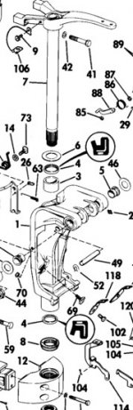

What happens is corrosion builds up around swivel bushing, #3 causing it to squeeze tightly onto the swivel pin #7. No real cure, except to take it apart (not an easy job) and clean the corrosion out, then keep it greased in the future.
Not recommended, but some have been known to heat the crap out of it with a big torch, partially melting the bushing
