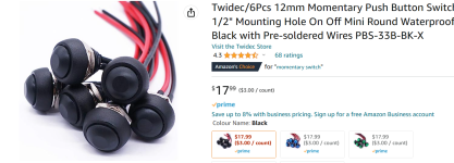

don't mess with the 50 year old design...
any "normally open" push switch can be used to kill the magneto by shorting the points... lots of them on amazon

Don't you think it's kind of a sexy idea to improve on the 50yo design by replacing the basic N.O. switch with a lanyard type that can do the same thing (if you pull the cord) AND offers an improvement in safety?

I'm ordering both types this morning. The lanyard switch appears to be long enough to extend out of the recess on the OB panel but if it doesn't I'll have the 'regular' button to install.
And as said--choking works fine, too 👍
