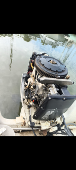

I have a Johnson 60 horsepower 2-stroke engine roughly 1975 struggling to start just splutters and cuts out or revs high and cuts out. The red manual primer lever inside is loose and sometimes leaks fuel if pulled out slightly. Been sitting for 12 months but apparently was running then however I don't know whether to scrap it and get a newer four stroke engine or spend on trying to fix it. Fuel delivery is ok and it's had the carbs cleaned last year but not ran since.

No red primer valve on 1975 models.----Need pictures and model #.-----Perhaps a newer powerhead ( 1985 ) was installed on a 75 model

Motors were NOT white in 1975.----Clearly is a newer ( 1988 3 cylinder ? ) motor.----No such thing as a " temperamental " motor if it is in good condition.----Picture of cowling may help identify.

My engine is a UK model. Does this matter?
