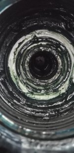

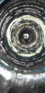

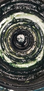

hi guys well im exhausted and beat trying to get the darn drive back in. Im pretty sure its way off. I can see the coupler raised from the bottom, im assuming engine is to high ?

does it look off to you bondo ?
You need an alignment tool to determine if the alignment is off Cant tell from photos.
put grease on the tool, put it into the coupler , the coupler will leave witness marks or marks in the grease to allow you to tell if it is centered. If you google mercruiser alignment tool you can find them relatively cheaply . If coupler is indeed high you need to raise your front engine mounts.
when you try to install the drive are you making sure the shift linakge is lined up, drive is in forward with pressure kept on prop in CCW direction so you can turn the prop and thus inout shaft to align the splines?

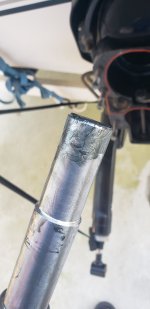

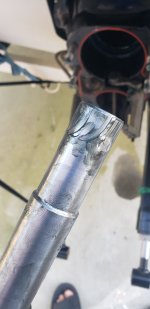

Ok i got the Alignment tool and it went in all the way but little hard to get out. I have to give it a good tug. I did see smears on the top of tool and nothing on the bottom

Stick the bar back in and give it a good hard whack with either your hand or a dead blow hammer - Up, Down, Left and Right. That will align the gimbal bearing to the coupler.
Next, pull the bar out and grease it twice as much - a good layer for all 2 inches of the smaller diameter end. Then do your witness mark test. Don't twist it as you pull it out.

501
ok i tried hitting it with a rubber mallet many times its a little better but not 2 finger in and out .. also seems like it doesnt seat in all the way only goes into the coupler about an inch , it can go in another inch or 2 if i tap it in with the mwllet but it will be hard to pull out
