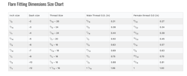

inverted thread size of power trim at cylinder and trim pump to manifold block

Bondo, pretty sure those are 3/8 inverted but what about the hose from the trim pump? 7/16ths??

  • Stainless End to Connector Block: 7/16-24 IF
  • Stainless End to Trim Pump: 3/8-24 IF

SAE inverted flare threads
if you are "repairing" the inverted flare port, there are specific cutters required.
