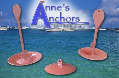

<br /><br /><br /> http://www.annesanchors.com/ <br /><br />you have a pretty big boat and depending on the worst conditions it has to not wonder away in will make a BIG difference in what you drop in the water<br /><br />the local people should no what works best up there<br /><br /><br />i kept a 24 ft in a harbor in orient point long island and it had to be BIG because every summer storm from the south really tore up the place and i have seen many boats drag small ground tackel to the beach<br /><br />i needed a 250# and ALL chain to keep a 24 ft 2700 # sailboat safe<br /><br />tommays

How did you get the granite to it's final resting place? We've got lots of that stuff up here.<br /><br />Thanks..<br /><br />And Tommaysss...<br /><br />You use the "Anne's Anchor"? Works well?<br /><br />Thanks

i used a mushroom that looked like it down here moorings are very controled<br /><br />my harbor was BAD in any northeaster and my boat allways stayed put :D <br /><br /> its not like you can do anything once the weather gets bad and it turns out to be a littel small :( <br /><br />you have to use the right stuff and there droped in a controled grid because thers a LOT of boats and you cant have them banging into each other<br /><br />and you cant put in garbage and let your boat take out 6 other boats in a storm :mad: <br /><br />i allways found out what the people who had been there a long time were doing and did what they did <br /><br />tommays
