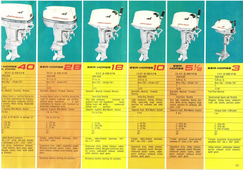

nwcove
May 16, 2011
6,293
Re: How to find year/model of 5.5 Johnson from serial #
Looks like a 1962.
b9303
Seaman Apprentice
May 25, 2011
37
Thank you all, it's a 1962 CD19. I guess a picture was worth a bunch of words !
