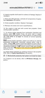

I’ve been looking into removing carbon deposits from my evinrude 50hp 4 stroke fuel injected, E50PL4SS, the manual says this should be done every 50hrs I bought the boat this summer and I doubt this has been done in the last 10years. The manual calls for Evinrude/Johnson engine tuner.The directions are to spray it in carbs or air intake, so with no carbs where would I spray it?

A modern 4 stroke should not need de-carboning ..........unless is burning oil for some reason ( and then de-carboning would be the least of your problems ) or if someone has sugared your tank .
If , like me , you just want to love your motor a bit there are other worthwhile things you can do . :)

Like most modern 4 strokes motors, this motor appears to be throttle body injected.
Remove the breather and spray the your "Snake Oil" of choice in the throttle body

That's either a miss print, from a two stroke or a manual that covers everything.
If an auto like my dead grandmother's Cadillac....was driven slow all the time then the valves get carbon on them. We used to pour tranny fluid down the carb while running and smoke the living snot out of a city block. Turn it off and wait a day, then drive it like you stole it.
Outboards can't really be lugged much....unless your just pulling logs all day at slow speeds.
I'd put the "new in a can" away and find another thing.
Also, I wouldn't fix something that doesn't need fixing. Would you do that to your lawnmower?
Shouldn't hurt anything...just can't justify I guess.
